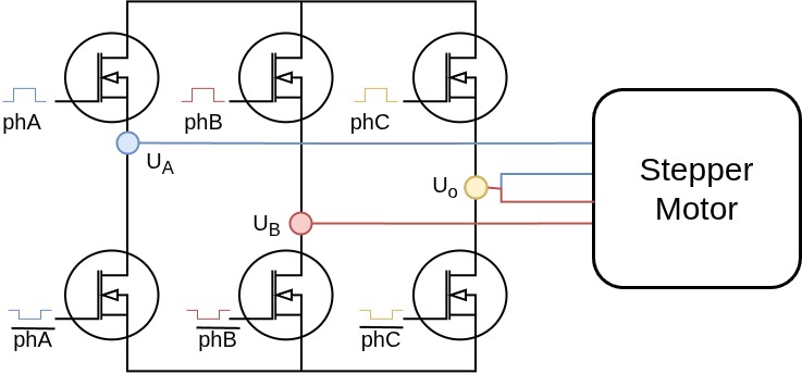

⚠️ Note: When using the 3PWM BLDC driver with a stepper motor, ensure that the common phase Uo is connected to the driver’s C phase pin.

⚠️ Note: When using the 3PWM BLDC driver with a stepper motor, ensure that the common phase `Uo` is connected to the driver's C phase pin.
Even if the common phase Uo is physically connected to some other driver output (A or B), please provide it as the C phase pin in the driver constructor. This is important for the correct operation of the stepper motor.
Consider an example of the driver connected to the MCU pins as follows:
#define PIN_A 9
#define PIN_B 10
#define PIN_C 11
#define ENABLE 8
If the common phase Uo is connected to the driver pin A, you should still provide it as the C phase pin in the driver constructor:
// common phase `Uo` connected to driver pin `A` so it is provided as the `C` phase pin
BLDCDriver3PWM driver = BLDCDriver3PWM(PIN_C, PIN_B, PIN_A, ENABLE);
If the common phase Uo is connected to the driver pin B, you should provide it as the C phase pin in the driver constructor:
// common phase `Uo` connected to driver pin `B` so it is provided as the `C` phase pin
BLDCDriver3PWM driver = BLDCDriver3PWM(PIN_A, PIN_C, PIN_B, ENABLE);
Or if the common phase Uo is connected to the driver pin C, you should provide it as the C phase pin in the driver constructor:
// common phase `Uo` connected to driver pin `C` so it is provided as the `C` phase pin
BLDCDriver3PWM driver = BLDCDriver3PWM(PIN_A, PIN_B, PIN_C, ENABLE);
