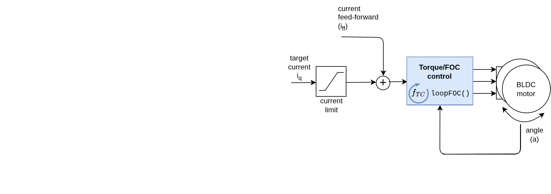

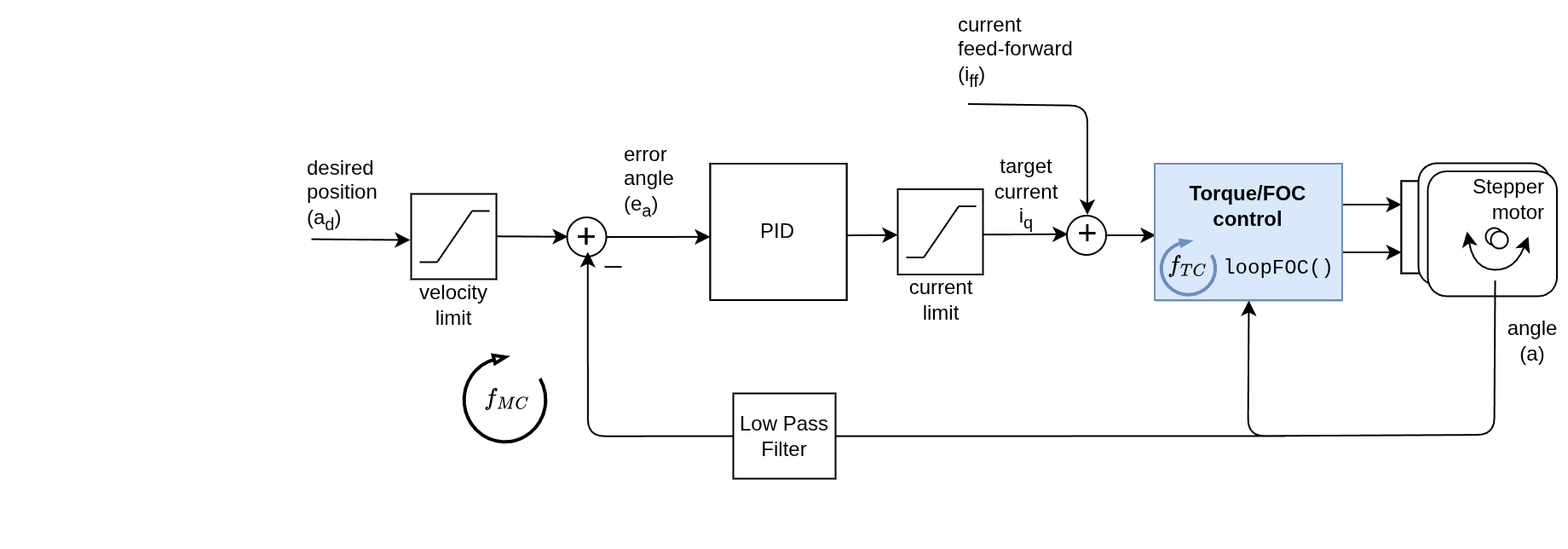

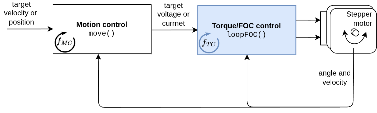

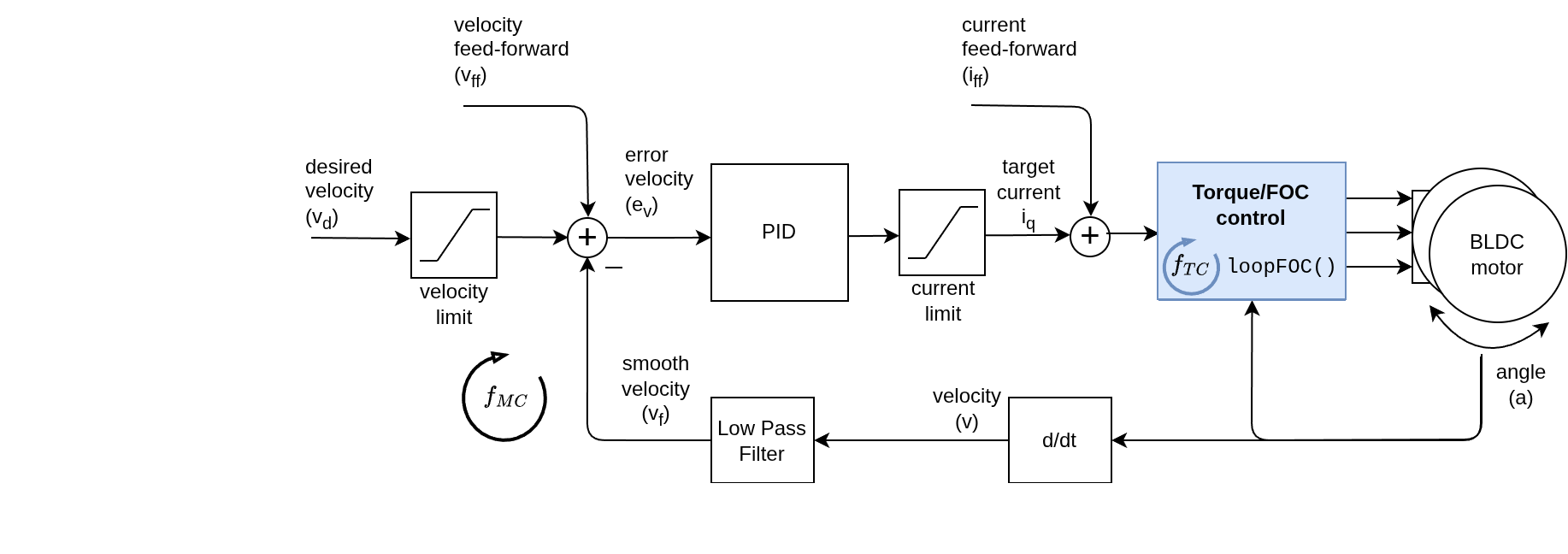

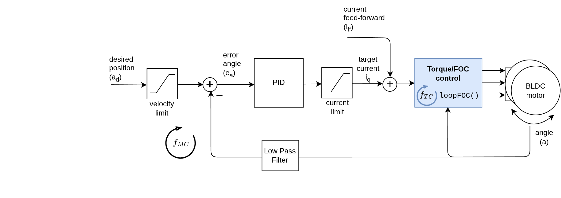

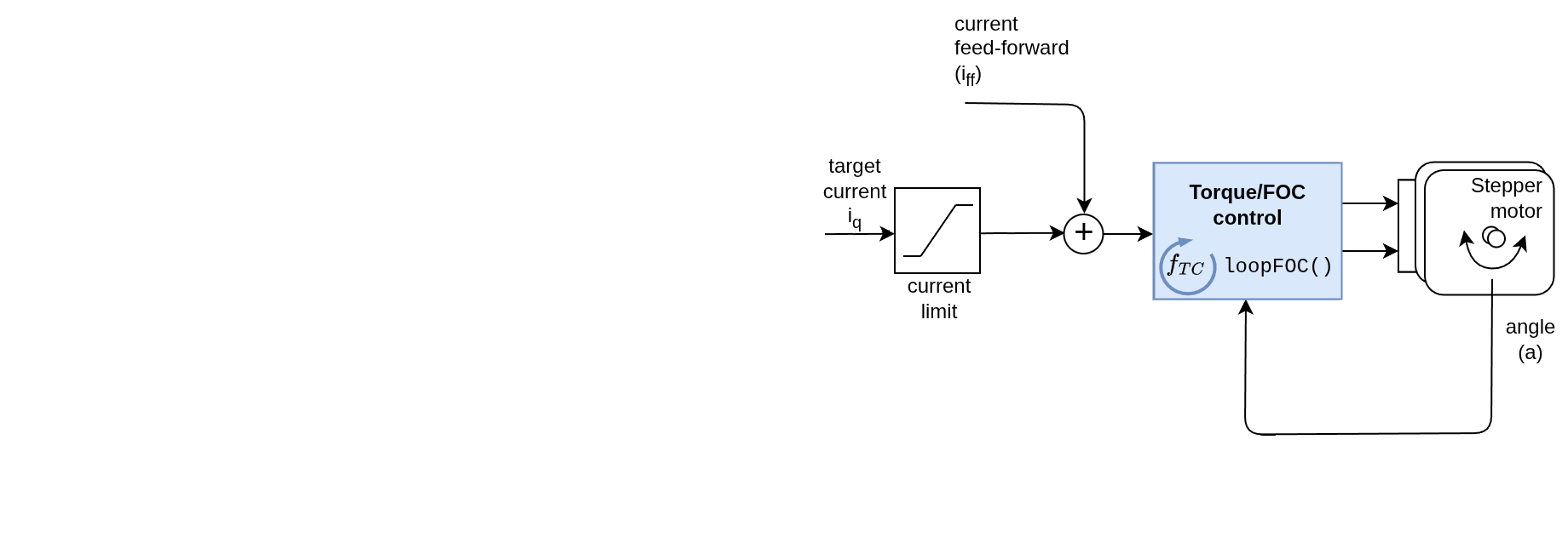

This is the standard motion control approach where the position sensor is used to provide feedback to the motion control loop. The motion control loop (motor.move()) will calculate the target torque (current or voltage) to be applied to the motor using the underlying torque/FOC control loop (motor.loopFOC()) in order to achieve the desired motion.
SimpleFOClibrary gives you the choice of using 3 different Closed-Loop control strategies:
// set FOC loop to be used
// MotionControlType::torque
// MotionControlType::velocity
// MotionControlType::angle
// MotionControlType::angle_nocascade
Torque control Velocity control Position/angle control
MotionControlType::torque MotionControlType::velocity MotionControlType::angle or
Go to Torque control docs Go to Velocity control docs Go to Position/angle control docs
