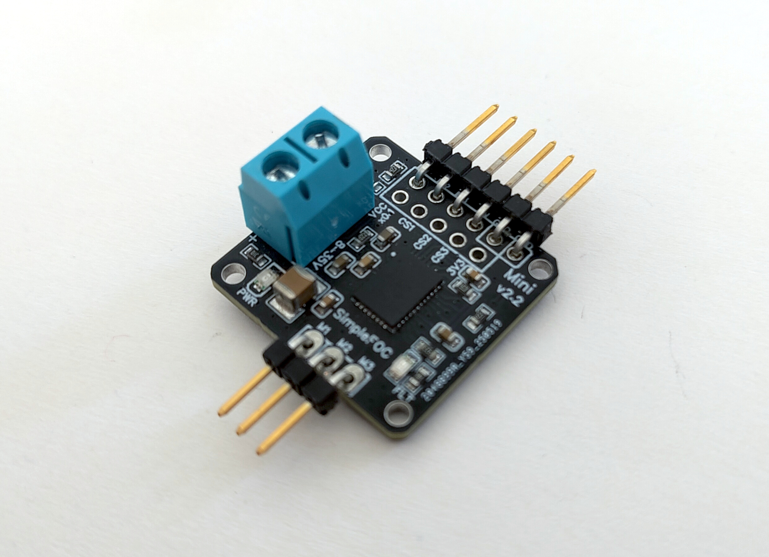

SimpleFOCMini is a compact BLDC driver for use with the SimpleFOClibrary. Version 2 replaces the DRV8313 with a DRV8316 and adds three-phase low-side current sensing and supply-voltage sensing. Its PWM and enable pinout remains compatible with Mini v1.1, so existing control code can be reused.

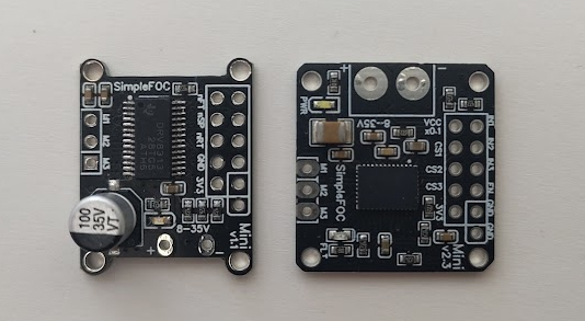

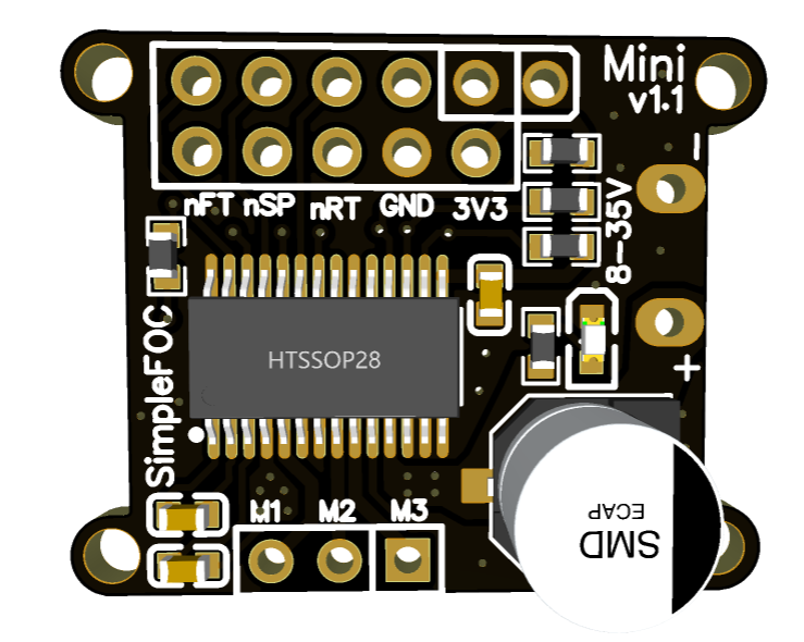

Feature Mini v1.1 Mini v2.3
Image SimpleFOCMini v1.1 top view SimpleFOCMini v2 top view
Motor driver DRV8313 DRV8316
Power supply 8-35V 5-35V
Maximum current 2.5A per phase 8A
Current sensing Not integrated Three-phase low-side (150mV/A)
Supply-voltage sensing Not integrated Integrated (VIN/11)
3.3V regulator output Up to 10mA Up to 20mA
Board size 20 x 26mm 24 x 25mm
PWM and enable pinout Original layout Compatible with v1.1
The v2.3 board is a complete redesign, but retains the v1.1 PWM and enable pinout and is compatible with code written for Mini v1.

Features of SimpleFOCMini v2.3
  • Plug & play: In combination with Arduino SimpleFOClibrary
  • DRV8316 based - datasheet
    • Power supply: 5-35V
    • Maximum current: 8A
    • 3-PWM mode
  • Sensing:
    • 3x Low-side current sensing (150mV/A)
    • Power supply voltage sensing (VIN/11, 47k / 4.7k divider)
  • Onboard 3.3V LDO: Up to 20mA output
  • Small size: 24x25 mm, with 4 mounting holes for M2 screws
